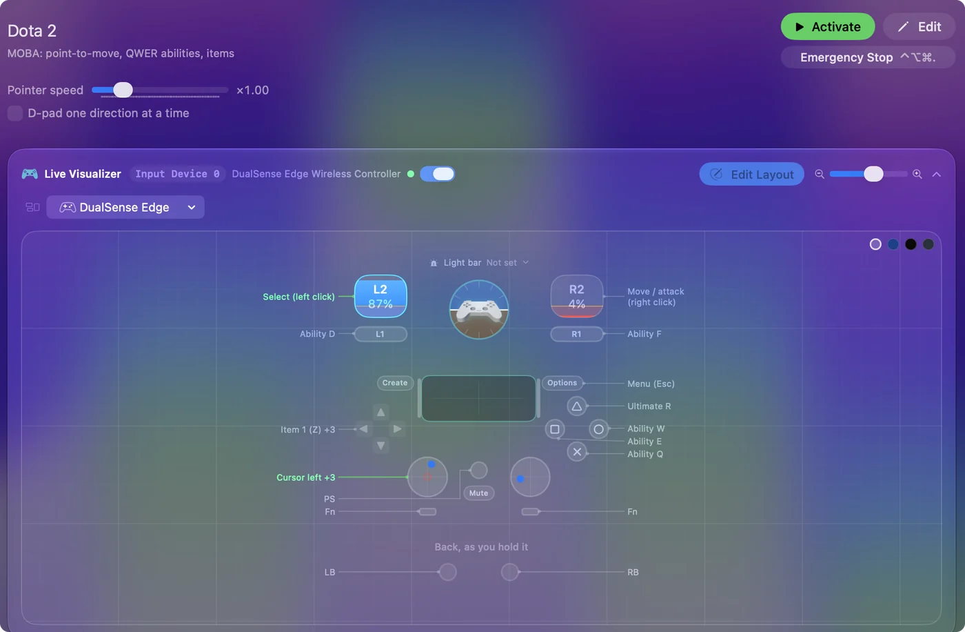

The Dota 2 preset in InputConfig, drawn on a DualSense Edge with each control labeled with the key or action it sends.
Figure 1. The Dota 2 preset drawn on a DualSense Edge in InputConfig's Live Visualizer. For example, Right trigger is labeled Move / attack (right click), and Left trigger is labeled Select (left click). Any other controller shows the same layout on its own drawing.
