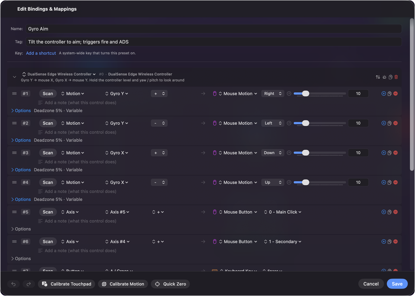

  • Gyro Aim. Wires sideways tilt to mouse X and forward tilt to mouse Y, with fire and aim on the triggers, pause on LB, and re-zero plus center on RB. See Gyro Aim.

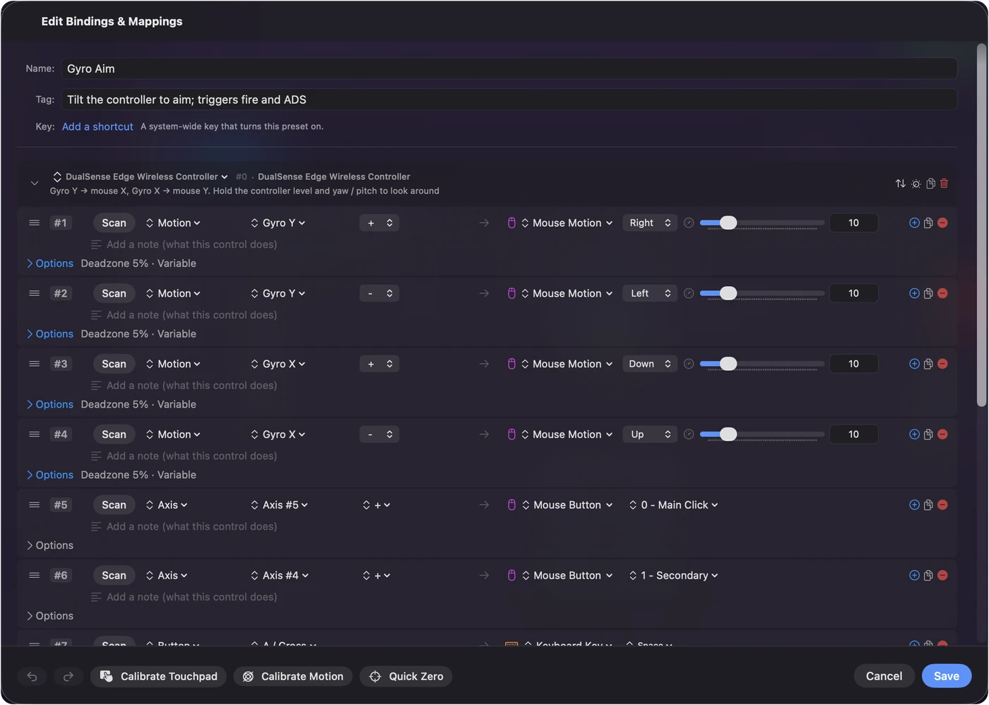

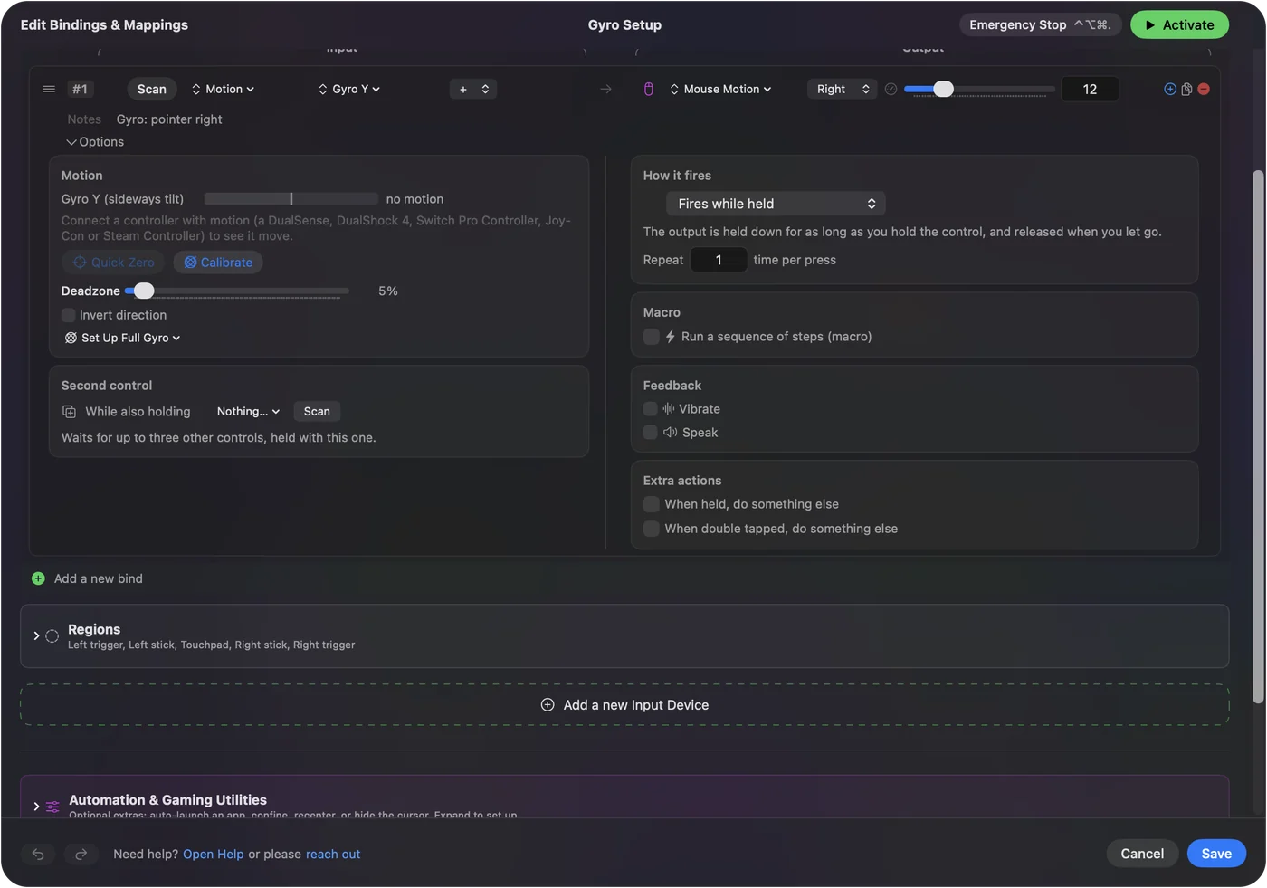

The InputConfig binding editor showing the Gyro Aim preset: Gyro Y plus and minus bound to mouse motion right and left, Gyro X plus and minus bound to mouse motion down and up, each with a 5 percent deadzone and variable sensitivity, and the triggers bound to mouse clicks
The built-in Gyro Aim preset. Four motion rows cover yaw and pitch, and the triggers click. Copy these four rows to add gyro to any layout.

  • You: Set the input type to Motion, pick the channel and plus or minus, one row each, and give it Mouse Motion in the matching direction.
  • InputConfig: Moves the pointer by the controller's tilt. Speed sets how far the pointer travels per degree.
  • Check: Tilt the controller up and the pointer goes up; tilt back to level and it comes back.
Four rows, plus and minus on two channels, make a full gyro pointer.

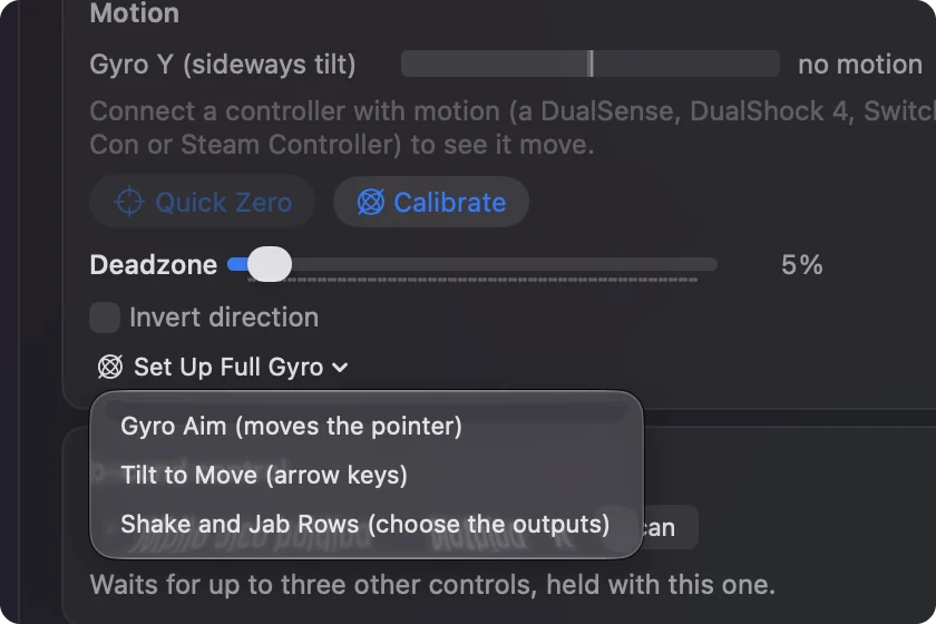

Or pick Set Up Full Gyro on any motion row. It adds the rows a full setup needs to that device: gyro aim for the pointer, tilt to move with the arrow keys, or one row per shake and jab with the outputs left to you. Rows the device already has are skipped.

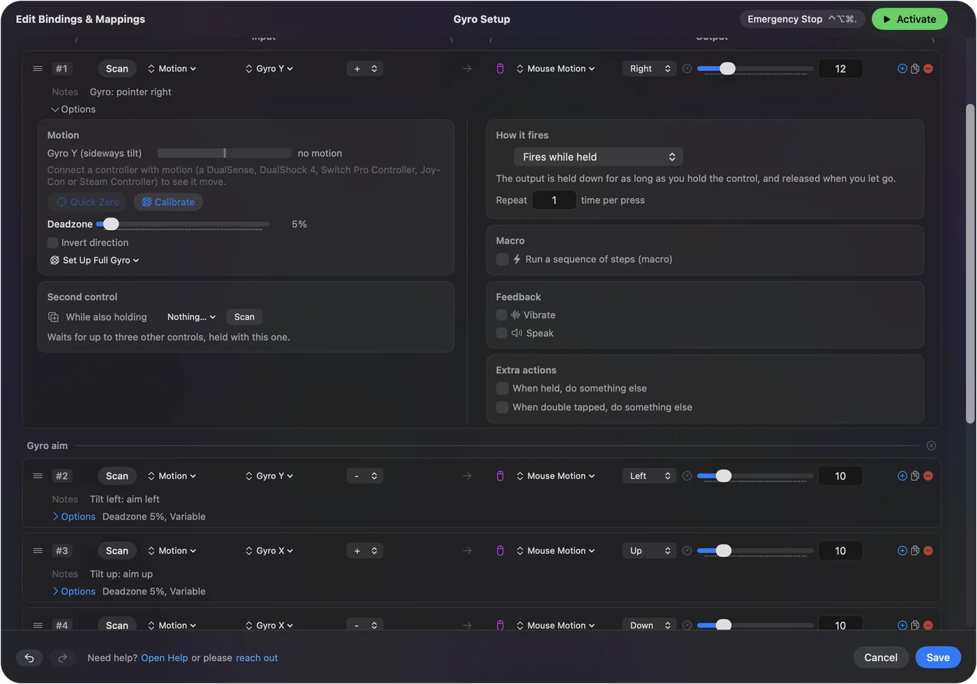

A motion row in InputConfig's editor with its Options open and Set Up Full Gyro under the Deadzone slider.
Figure 1. Open a motion row's Options. Set Up Full Gyro sits under the Deadzone slider.
The Set Up Full Gyro menu with Gyro Aim, Tilt to Move and Shake and Jab Rows.
Figure 2. Set Up Full Gyro offers three sets: aiming, tilting to move, and shakes and jabs.
Three gyro rows added under a Gyro aim heading in the editor, each sending Mouse Motion.
Figure 3. Gyro Aim adds the other three aiming rows under their own heading.

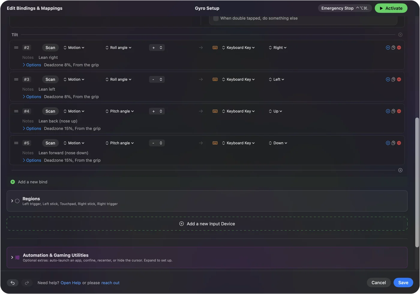

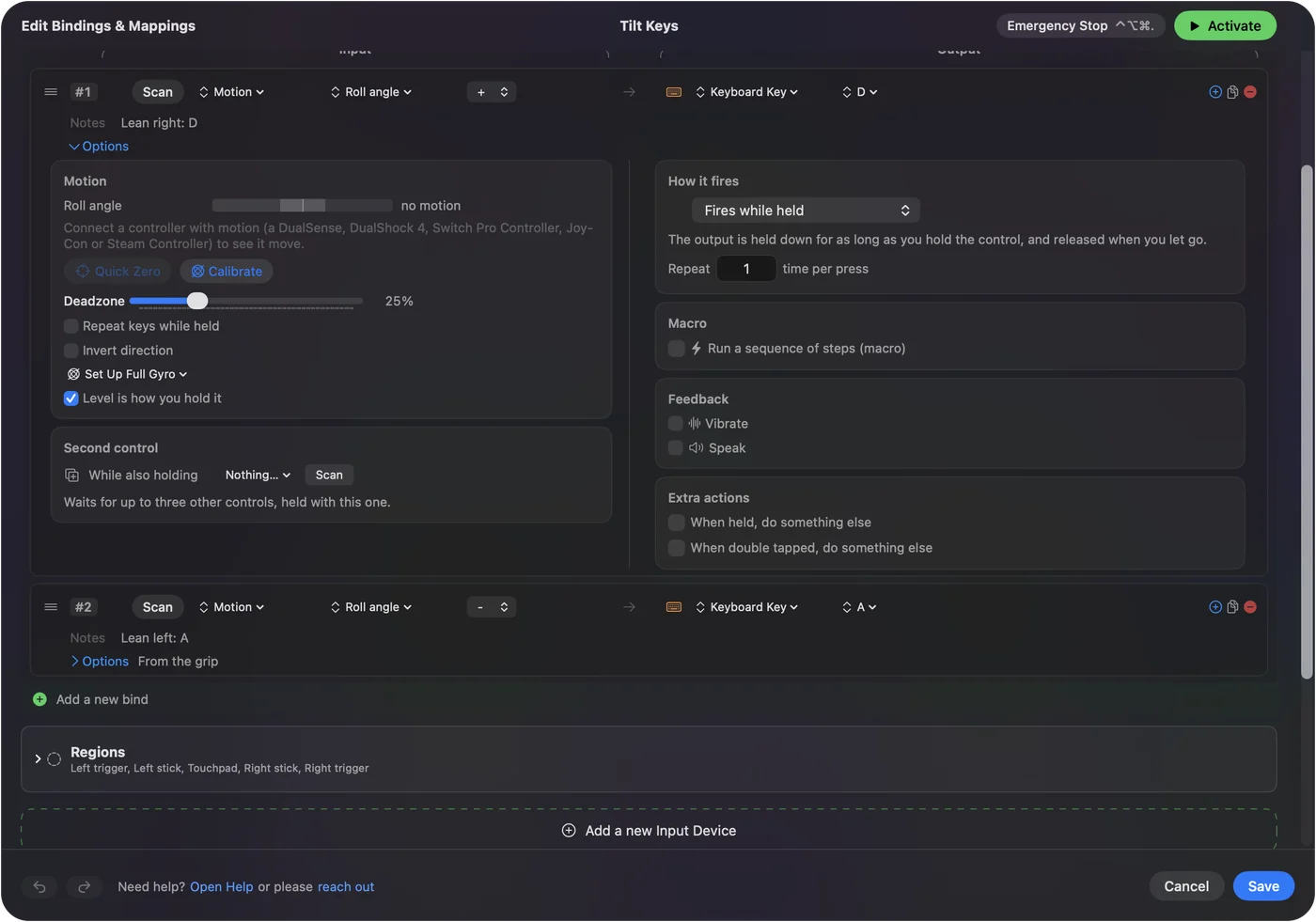

Four tilt rows in the editor, each sending an arrow key as the controller leans.
Figure 4. Tilt to Move adds four lean rows on the arrow keys.

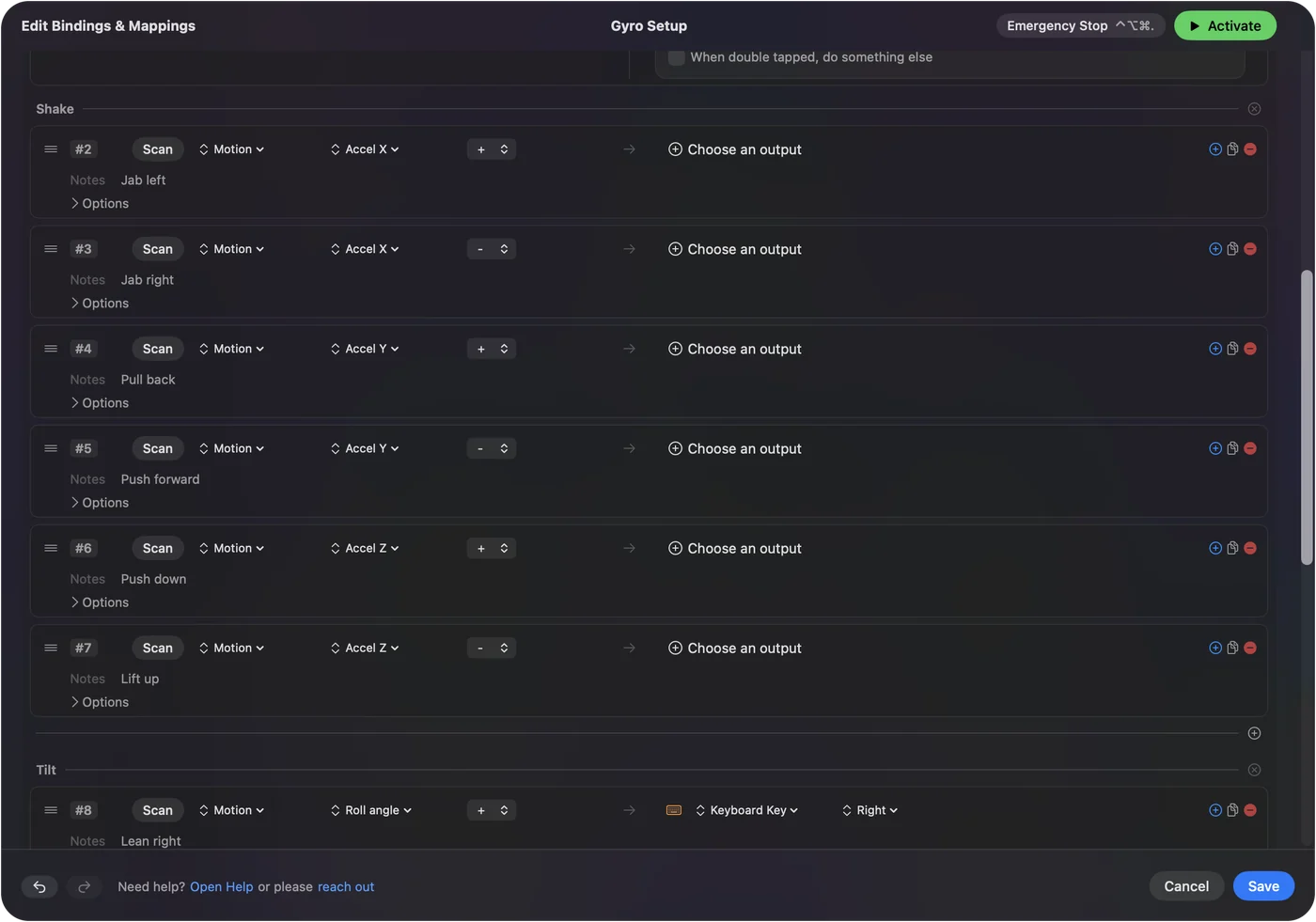

Jab and shake rows in the editor, each waiting for an output.
Figure 5. Shake and Jab Rows adds the rows and leaves the outputs to you.

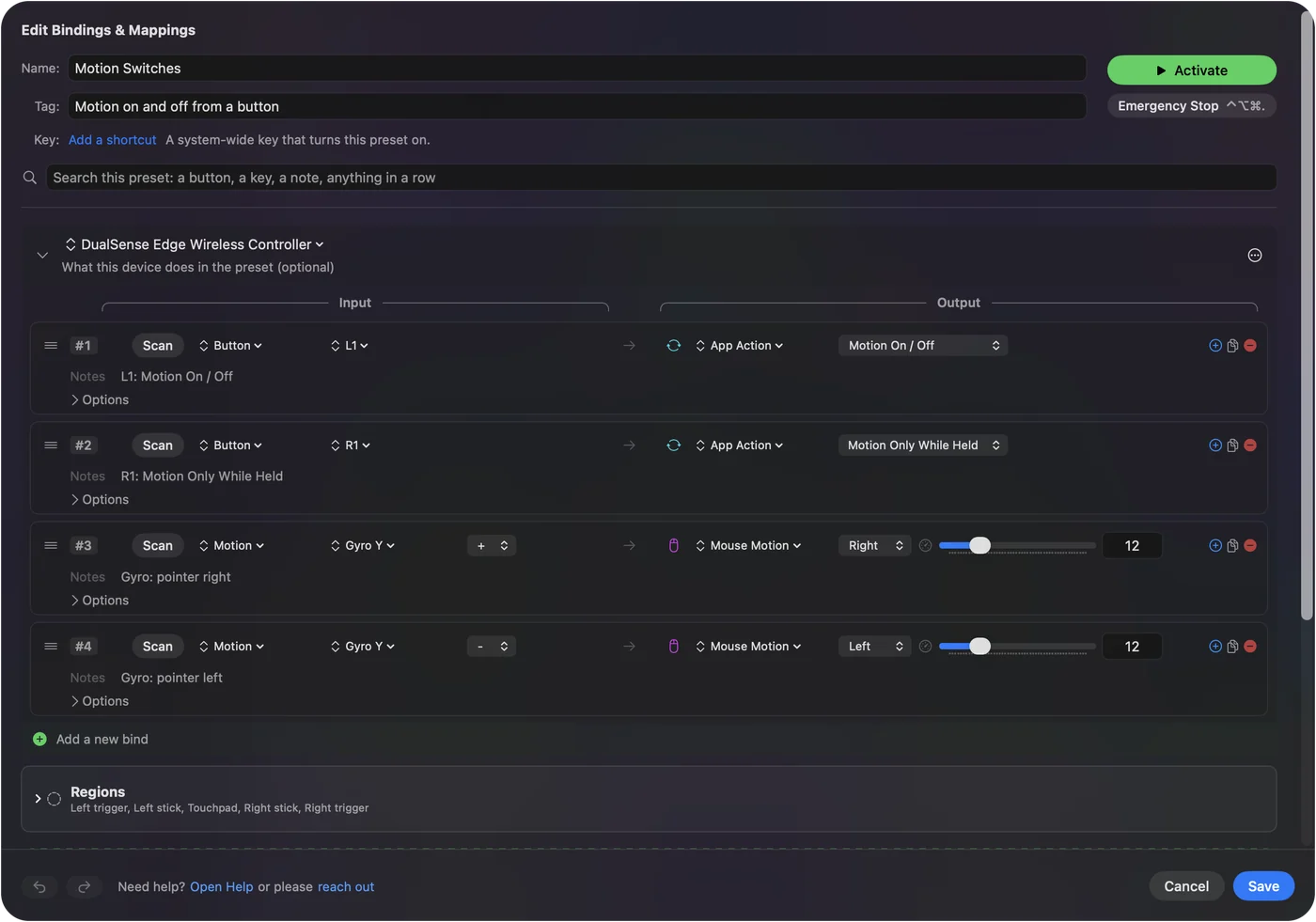

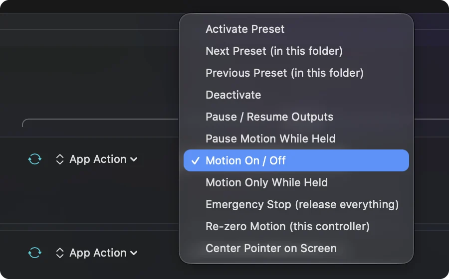

Two more App Actions switch motion. Motion On / Off turns it off with one press and on again with the next. Motion Only While Held lets the motion rows work only while its button is held. Each works from any input, a keyboard key or a foot pedal included.
Two button rows in the editor: L1 sends Motion On / Off and R1 sends Motion Only While Held, above two gyro rows.
Figure 6. L1 turns motion on and off. R1 keeps it on only while it is held.
The App Action menu in the editor with Motion On / Off checked, beside Pause Motion While Held and Motion Only While Held.
Figure 7. All three motion switches are App Actions.

A tilt row's Options in the editor with Level is how you hold it turned on.
Figure 9. Level is how you hold it: the tilt counts from the way you hold the pad, not from flat on a table.
