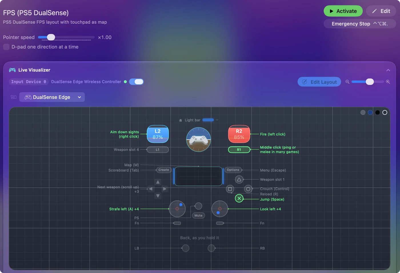

The InputConfig Live Visualizer drawing a connected controller, with the pressed button and the moved stick lit up.
Figure 1. When the Live Visualizer lights the pressed button and the moved stick, the Mac is reading the controller.
