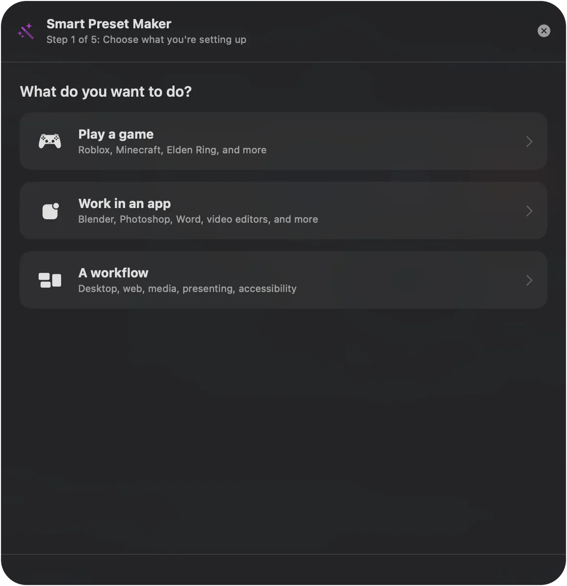

The Smart Preset Maker's first step, asking what the preset is for.
Figure 2. Step 1 asks what the preset is for.
