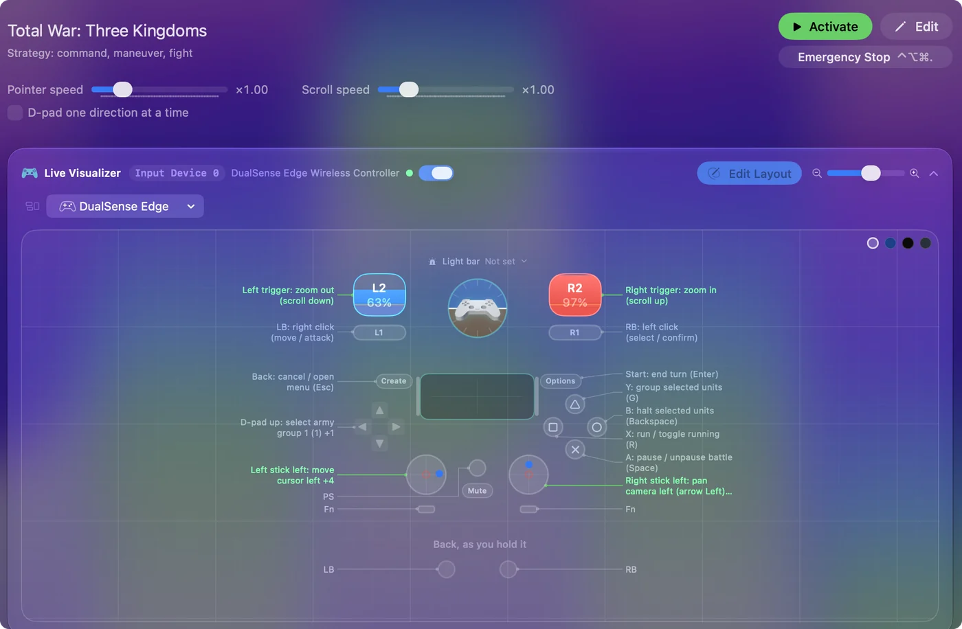

The Total War: Three Kingdoms preset in InputConfig, drawn on a DualSense Edge with each control labeled with the key or action it sends.
Figure 1. The Total War: Three Kingdoms preset drawn on a DualSense Edge in InputConfig's Live Visualizer. Any other controller shows the same layout on its own drawing.
